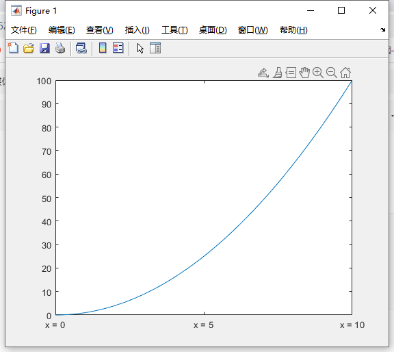

x = linspace(0,10);y = x.^2;plot(x,y)xticks([0 5 10])xticklabels({'x = 0','x = 5','x = 10'})

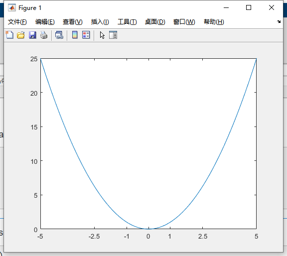

指定非均匀 x 轴刻度值,沿 x 轴以介于 -5 和 5 之间的非均匀值显示刻度线
x = linspace(-5,5);y = x.^2;plot(x,y)xticks([-5 -2.5 -1 0 1 2.5 5])

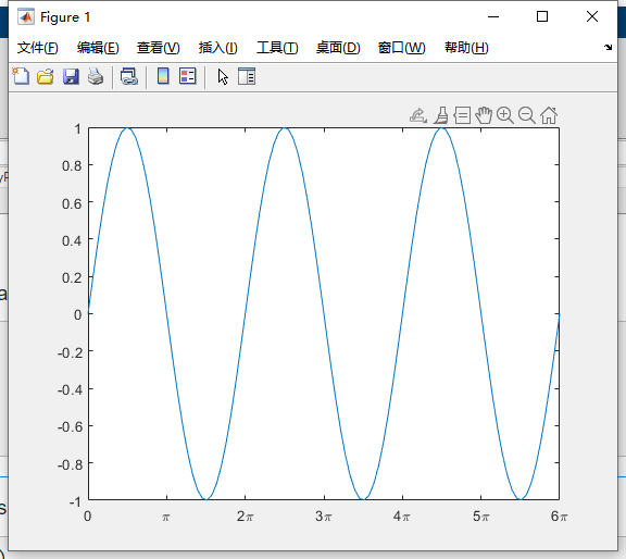

以 Pi 为增量递增 x 轴刻度值,创建一个线图。将 x 坐标轴范围指定为 0 到 6π。然后,以 π 为增量显示 x 轴的刻度线。
x = linspace(0,6*pi);y = sin(x);plot(x,y)xlim([0 6*pi])xticks(0:pi:6*pi)xticklabels({'0','\pi','2\pi','3\pi','4\pi','5\pi','6\pi'})

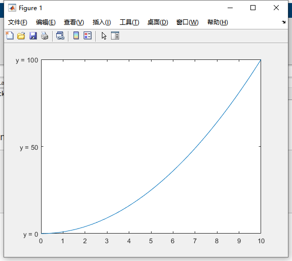

x = linspace(0,10);y = x.^2;plot(x,y)yticks([0 50 100])yticklabels({'y = 0','y = 50','y = 100'})

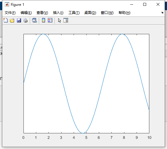

删除 y 轴刻度线,通过将刻度值指定为空数组来删除沿 y 轴的刻度线。
x = linspace(0,10);y = sin(x);plot(x,y)yticks([])
