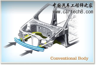

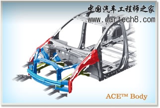

所谓本田的ACE车身结构,Advanced Compatibility Engineering,顾名思义,在小客车和轻型卡车上更新的一种新型车身结构,主要是发动机舱这块的结构增强系统,从前轮罩侧面和FENDER过渡梁、BUMP BEAM和前纵梁等处的多碰撞力分散结构,从而减少因碰撞侵入乘客舱的风险。撇开国内HONDA车身结构的烂事,我们可以从引进欧美和其本土的车型结构,认识到ACE对我们国内车身结构发展的方向,是值得借鉴的。
The ACE® body design, helps spread out the forces of a collision to help avoid concentrated impact forces that cause injuries.
A conventional body structure concentrates the energy from a collision primarily through two side frame rails.
